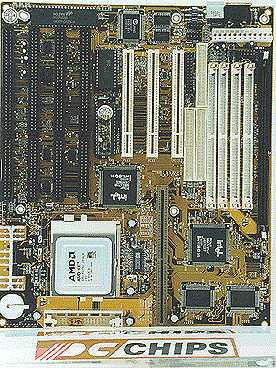

The complete BIOS string is;
06/21/96-i430VX-2A59Ht5BC-00
It also says
Award Modular BIOS v4.51PG
and
Award Plug and Play BIOS Estension v1.0A
The t5 identifies it as a Tyan board - it's nearly a S1469
[http://th99.piloti.dyndns.org/m/S-T/34137.htm]
but there are only 3PCI slots instead of 4,
1 DIMM instead of 2,
and the BIOS chip is situated between the PCI and the ISA slots.
There are other minor differences in positioning of jumpers.
At present it is refusing to recognise either the FDD or CDROM, both in DOS and in Windows 98, so trying to use an identification program is impractical.
There are no identifying marks on the mobo.
Chip appears to be;
ALi M5818 B1
G629 AG1137 - which I can't track down either...
Cheers!

Not at all a Tyan board. Check the bios string carefully. There should be only uppercase letters there. Yours has a lowercase "t" and the chipset designator is wrong. i430VX should be 2a59G, not 2A59H. This is an illegal bios used by PC Chips/Hsin Tech. You most likely have a variant of the M520 board.

These are all variations of the same board.i430VX-2A59Ht5BC-00 boards:-
3 PCI, 4 ISA, 4 Simm, 1 Dimm, 1 USB = PcChips M520 or Skywell SW5100.
3 PCI, 4 ISA, 4 Simm, 1 Dimm, No USB = Amptron PM7900 or Skywell M520.
4 PCI, 3 ISA, 4 Simm, 1 Dimm, No USB = Amptron PM8800.
4 PCI, 3 ISA, 4 Simm, 2 Dimm (or 4 Simm, No Dimm), optional USB = Pine PT-7502 (3 versions).
3 PCI, 4 ISA, 4 Simm, 1 Dimm, 2 USB = Houston Tech M520.
Amptron PM7900.

The bios software used on the board was "pirated" that is the license was most likely not paid for, the bios is not faulty.
If you have another motherboard that is the same or similar you could do a "hot swap" to flash the bios or you could send the bios chip away to be reprogrammed with an eprom burner or you could buy a replacement bios chip outright.
