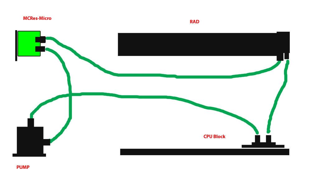

Is you heard it :haha: T2 is finally going water cooled.
I will be making a Water Cooled Bench Station for OC'ing and Benching.
The tech Station will have Swiftech Items :thumbsup:
1xApogee™ GTX water-block
1x MCP655™ pump With a speed controller (part # MCP655)
1x MCRes-Micro
1x MCR320-QP (Quiet Power™) Radiator
3x
Cooler Master Y720CCD-25K1-GP 120mm Silent Fans
10ft of
Tubing: 1/2 in. (ID) x 3/4 in. (OD) Clearflex Vinyl Tubing
Cooling a X6800 CPU on a BFG 680i motherboard
Here is a Quick Draft :pimpin:
More to Come :evil:

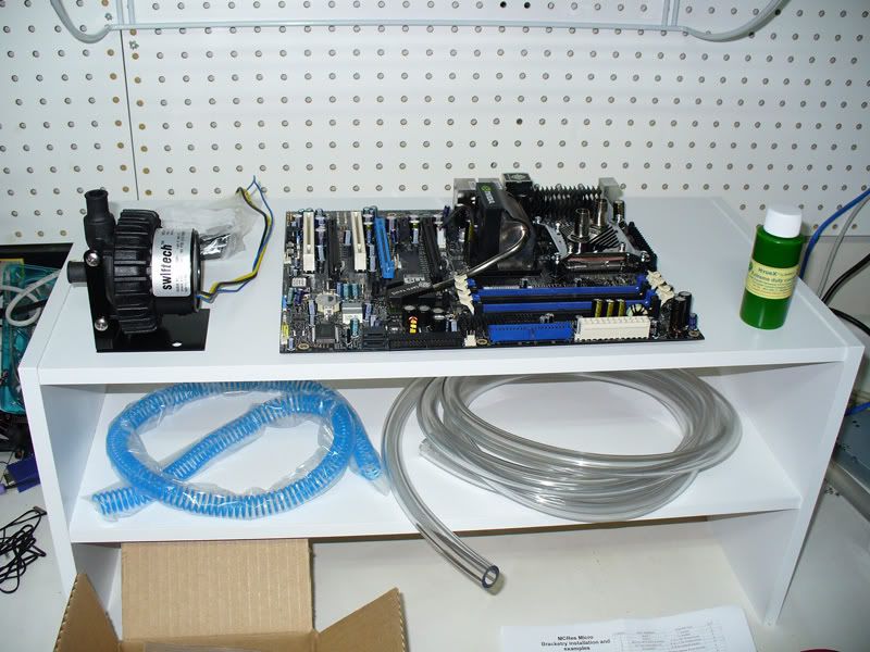

Here are the Fans
Fans mounted
Test Setup
Added Bling :evil:

Ideally in a watercooling setup the pump should go straight to the radiator to be sure it removes any residual heat it dumps into the fluid before it gets to the cooled parts.

Hummm Ok :D
This was my first water cooled setup PDT_Armataz_01_01
I will try to change the Lines around :wink:

Nice job so far. In case I wasn't perfectly clear earlier, this is the optimum setup for watercooling...
  • reservoir
  • pump
  • radiator
  • CPU
  • other cooled parts in your preferred order
  • back to reservoir
A larger reservoir the better, as it will give the fluid time to cool even more before being sent back in to the loop.

I've setup my passive water coooling so that the pump pulls the warm water from the blocks then dumping it to the reservoir before it gets to the rads to be cooled further more and then pushes the cooled water from the rads to the blocks :wink:
Similar concept, but depending on the pump it will probably work better when the pump is pushing, not pulling.

Yeah as it is mostly setup that way but using a bigger and more powerful pump (I have the eheim 1250) would pretty much be more flexible such as extracting the heated water off the blocks quickly (well that's just a little theory I wanted myself to believe LOL)
Anyway... as long as you don't put the pump right before the blocks to dump water directly to the blocks... he should be fine :)
